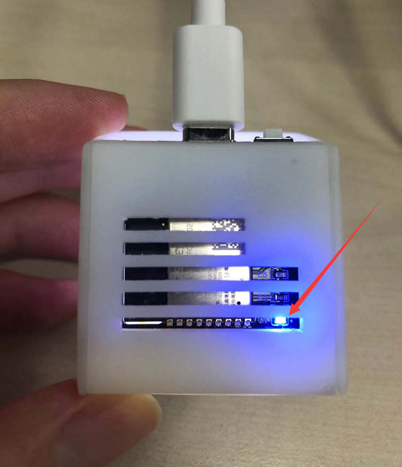

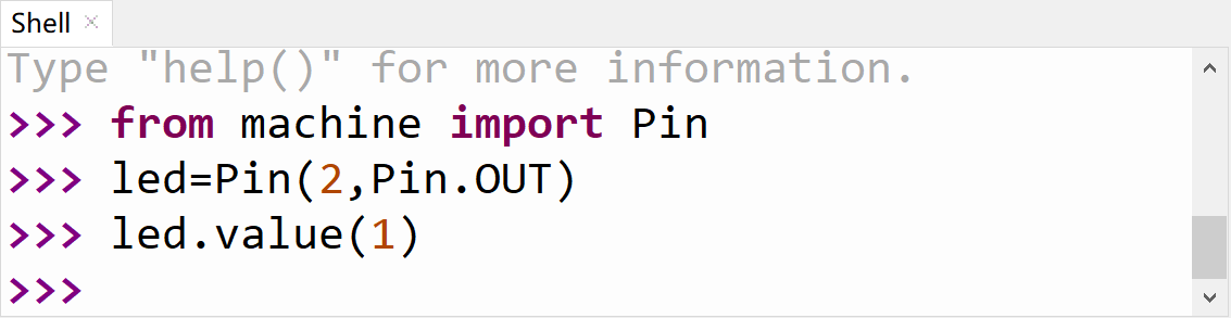

LED = Pin(2, Pin.OUT)
LED.value(1)
repl1
repl1
