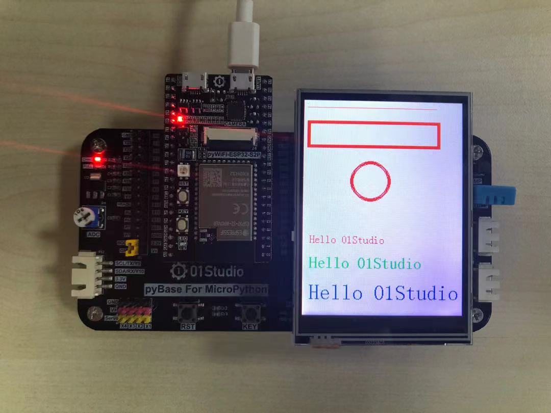

from tftlcd import LCD32
# 构建3.2寸LCD对象并初始化
d = LCD32(portrait=1) #默认方向竖屏
#填充白色
d.fill(WHITE)
#画点
d.drawPixel(5, 5, RED)
#画线段
d.drawLine(5, 10, 200, 10, RED)
#画矩形
d.drawRect(5, 30, 200, 40, RED, border=5)
#画圆
d.drawCircle(100, 120, 30, RED, border=5)
#写字符,4种尺寸
d.printStr('Hello 01Studio', 10, 200, RED, size=1)
d.printStr('Hello 01Studio', 10, 230, GREEN, size=2)
d.printStr('Hello 01Studio', 10, 270, BLUE, size=3)
time.sleep(3) #等待3秒

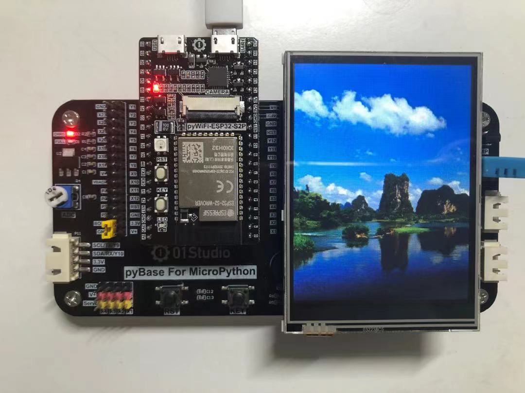

#显示图片
d.Picture(0,0,"/picture/1.jpg")
time.sleep(3)
d.Picture(0,0,"/picture/2.jpg")
time.sleep(3)
d.Picture(0,0,"/picture/01studio.jpg")

  • 点、线、字符等显示

  • 显示图片
